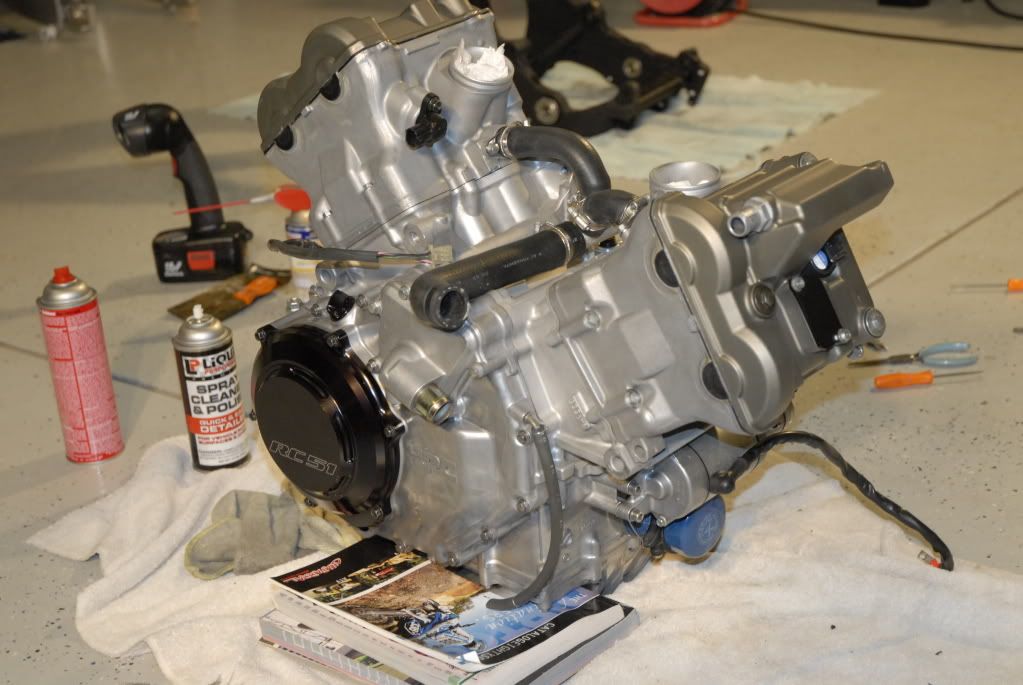

I finished disassembly yesterday and started to reassemble the frame and engine today. It took many hours with picks and small screwdrivers to remove all the built up bugs, tire, and crash dirt from the engine.
This is about as far as I can go for now. Waiting on new All Balls steering bearings and new swingarm bearings.

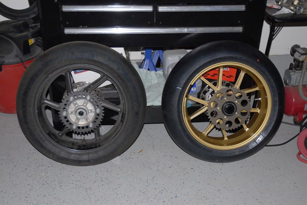

So how much weight do you really save with a forged mag Marchesini over OEM. 5.0lbs to be exact. Weighed both SP1 rear with OEM rotor, 44 tooth sprockets, and Dunlop 195/65R-17 Ntech slick 6680 compound. OEM 34.5LBS, Marchesini 29.5LBS
Im still waiting from my front to arrive, when it does I will weigh it compared to the OEM as well.

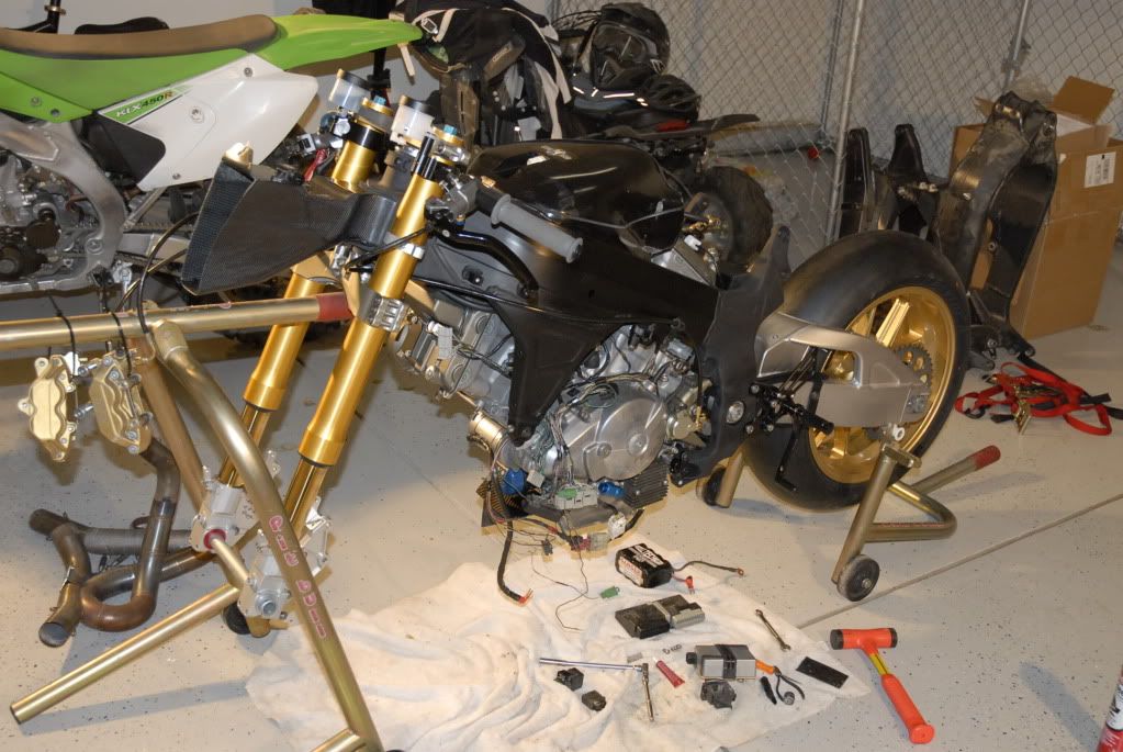

Other news, my Attack Triples came back fixed and are now straight. The new swingarm bearings arrived and I should have the bike on the stands by the end of next week.
Got the Swingarm bearings pressed in and used the stock link/shock to assemble for now. At least its on the stands where I can work on it. I should be able to get allot done over the next two weeks of vacation.

Spent the morning mounting the clip-ons and controls. I have a few things I need to change/update on my wire harness so that's next.
