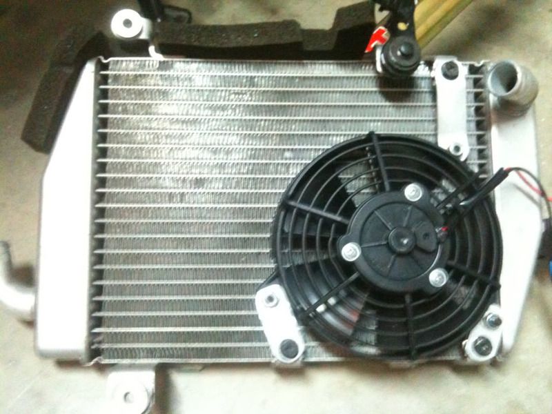

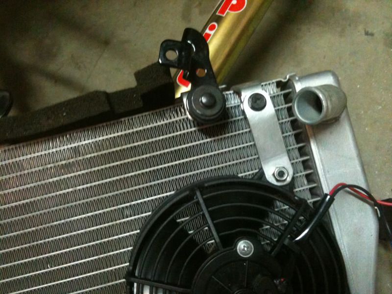

Well I got mine last week and after a few days of trying to figure out how to install it I got it done tonight. I used the oem top bracket had to bend it a little and trim some but got it to fit snug. For the bottom two I used some metal zip ties from home depot worked out gr8t. The reason I used the zip ties on the bottom was I did not feel like taking the whole radiator off. the fan works gr8 and couldnt be more happy .
