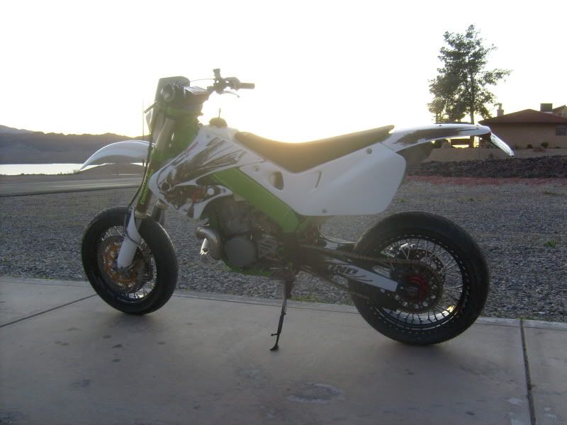

got the bearings for rear wheel but they are 2mm wider than the correct bearings (cant find them/not made anymore :brick:) so it moved my sprocket/tire edge over a bit more.... now the chain rubs the tire... so ill flip the front sprocket and space out the rear sprocket and it will be DONE.... :thumbs: ... was really really really hard to not test ride it today but i dont want a chewed up tire... the chain rub on the rim has kinda grown on me.. wont ever have to worry about that with the 160 rear tire on there plus it fits so perfect in this cr250 frame.... :laff:

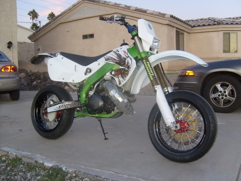

got the JEMCO mounted and HOLYCRAP !!!! it woke the monster up big time.... :thumbs::laff::grin:

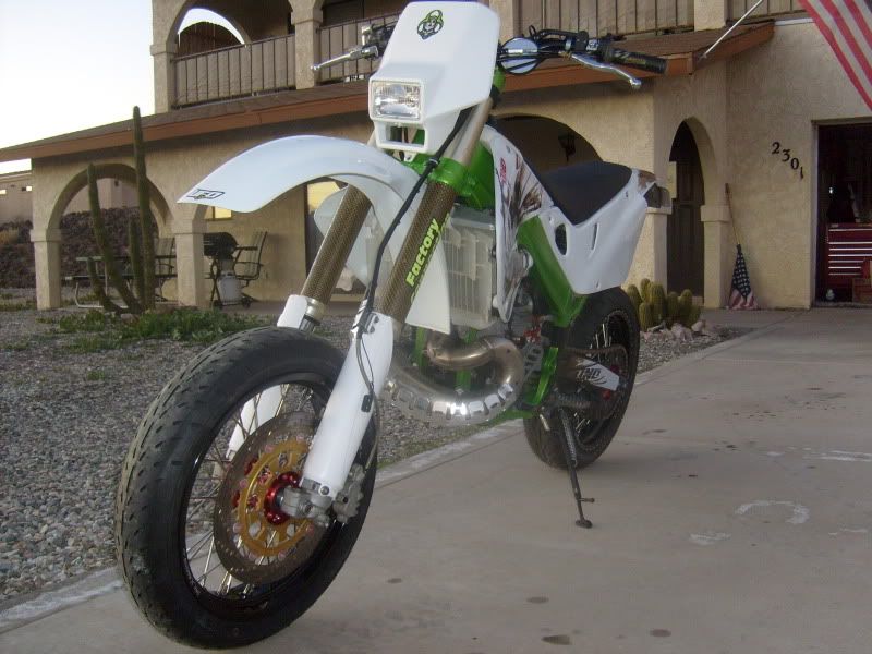

the view MOST are gonna get in the corners...:laff:
