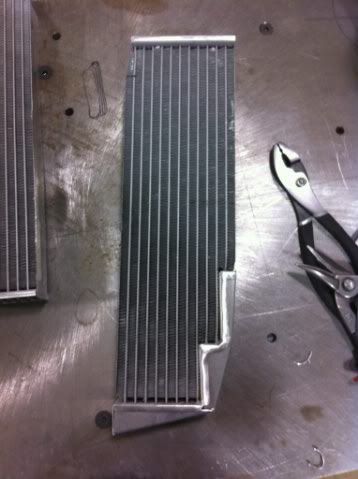

Here are some build pictures of the HRC replica front mount radiators that Mike Furick is building for me and a few others right now. If you like what you see get in touch with me and you can place your order for your own set as he will be building more once these sets are done.

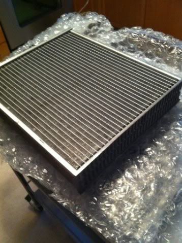

Here is what he starts with:
After a few days worth of painstaking work:

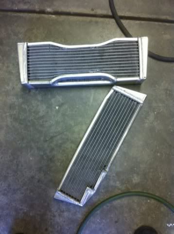

Extremely difficult brazing work:
The most complete set yet vs. HRC fiche, a beautiful site to see :notworthy :

When I indicated a price in the previous threads that was for the old style radiators and oil cooler. The new (hrc) style setup takes a double thick upper radiator core with more modification. Also the bottom radiator has hand brazed side tanks in which is alot of risk and alot of time. I do want it to be affordable and mimic the traditional look and most of all cool. So I know I can't offer a separate oil cooler for the old style price so I'm trying to make the stock oil cooler work. With modification. That's also includes modification on your head cover and water pump cover. And I looked today and I believe that I can make it fit without limiting you turning stops.

I'm curious to see how you're gonna make clearance for the return pipe from the lower fit inside the fairing (partly 'cos I'm considering solutions to this one myself). The HRC lower steps back 1 row on the right-hand-side, tapering at the bottom tank. Your lower doesn't seem to have that feature but I'm guessing you've already got a solution sorted.

being that i stepped the other side i should have enough room i briefly looked at and was sure when i looked at it it would fly but we will see. Also the bottom rads are real long compared to any other set on the market maybey the same as hrc but i havent a set to measure off of. But i know i crammed the longest possible.
