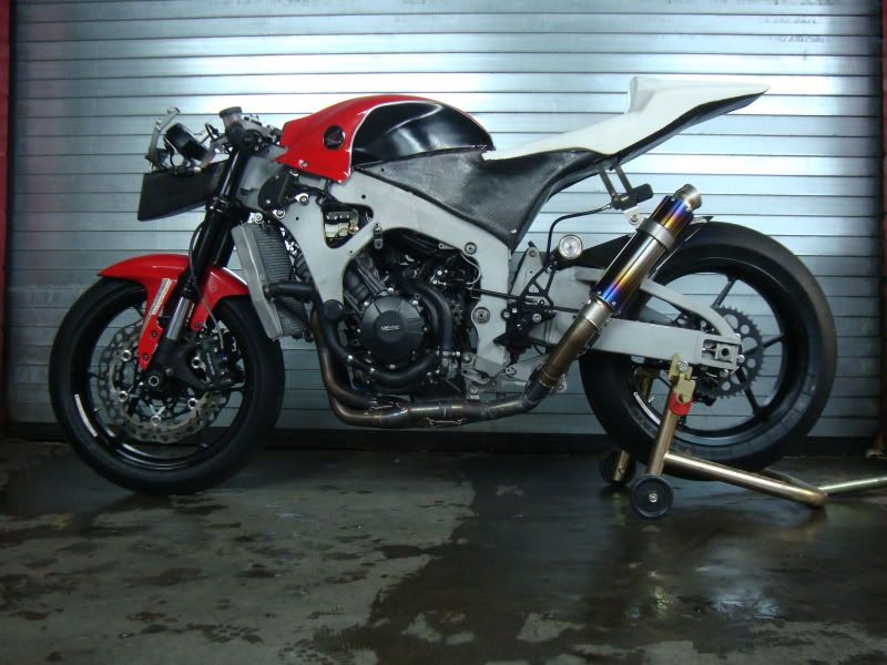

This time i'll start to show the build backwards so you can see what have i done to get it here.
its a 09 CBR600RR and it looks a little something like this:

and got busy on the tripple in the quest for lighter then stock
then desided to go with Carbon and Aluminum bracket for the upper since the OEM was so damn heavy anyways.
870 Posts
Discussion Starter · #11 ·
got the motor as a kit including the ECU and airbox
so i took of that harness and got busy on it removing over a 1 Lb from it not to mention all not needed controls.
then, i sent the frame, swingarm and tripple to get sandblasted raw and i treated it once back home

got lucky and found Arrow headers at the wera forum and the shop had a slip Arrow available so I got busy on them to make them exit out of the left so save weigh and for a straighter exit

got some rearsets and the exhaust was ready to be installed.
fitted the lower and installed the sliders
I then made an undertail out of alluminum sheet to try and recreate on fiberglass in the future and for a cleaner look.
