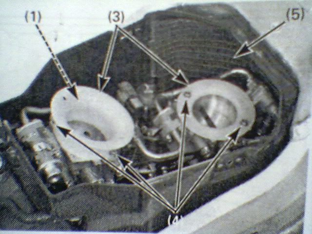

Sebastian, I only have 1 picture from the HRC kit manual and it shows no diverter, only a wire frame that held a thin foam filter in place. Ill post a pic up of it later but its B/W and not very clear.

I know this picture.
Two independent tuners have told me about it, one of them has seen such diverters in the Edwards bike.
They told me also, HRC has removed the diverters for some photo sesions...

OK OK heres the pics:
This is HRC kit, not factory HRC.
They may have very well put diverters into the factory bikes during different stages of testing, but it was never incorporated to the HRC kit.
As far as your preference for the open top box style Jeff, I see your logic but I am hoping that I get better results from the new box then the style your referring to that I sold to afford my new one. The mori/hrc boxes go down lower than the thorsten style, so Id be interested to see just how much more capacity one has over the other.
And yes, I have been told that the Moriwaki family has worked closely with HRC on many engineering design projects including RC51 airboxes, intake snorkles, velocity stacks and clip-ons, so if your looking at a mori part, it might be the same or similar to an HRC part.
