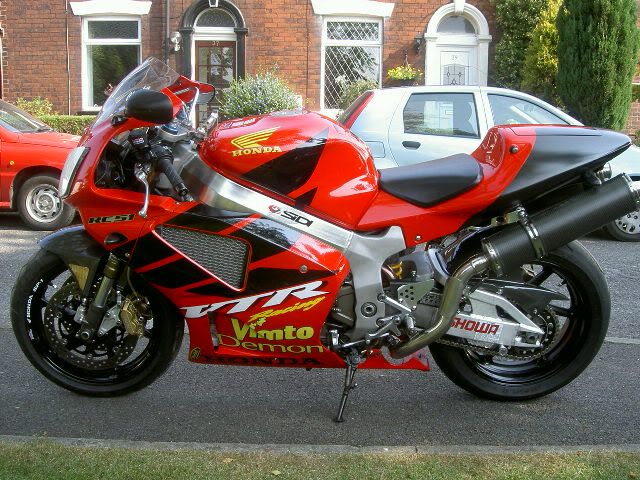

I have just fitted these high mount Leo Vince carbons and my bike has developed a sort of hic-up as i start off. I don't have a power commander so is there anything I can do to solve this. It feels like it is firing on one cylinder for a split second, and if i really whack the throttle open it dies for a moment ???? Help :eek: :eek:
59 Posts
I'd start by getting a power commander and then downloading the appropriate map for Leo Vince Cans off the PC website. Are you running standard air filters? If not there will be various maps for with or without standard filters.
See how it runs, then maybe get it properly set up on a dyno.
