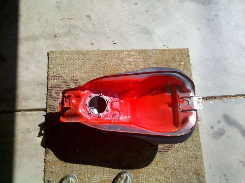

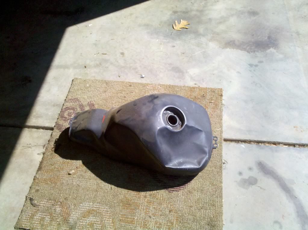

Cleaning out the garage, and I found this tank I had forgotten about. It's got a MASSIVE dent on top. Anyone want it? I don't know what to do with it besides throw it away. And before anyone asks, no it doesn't come with a fuel pump/cap. If no one replies in the next few days, it's going in the trash...

Just needs a little filler, and a new range of 100mls before it runs out of petrol.....
Actually it can be mended quite good visually.
There are 2 methods we've used for tank repair:
1. For small dents blowing compressed air is sufficient.
2. For “bit” larger dents this will not be enough and the repair shop will weld a rod to the center of the dent and pull it out (so that you don't need to refill immediately when leaving the gas station).
Than some filler, sanding, painting etc'... => "like new"
The main disadvantage of latter is that in some case the internal anti rust coating of the metal is damaged and as you'll be introducing corroded metal into the fuel system.....
The main disadvantage of the former method is that, too much pressure and the original welding are compromised.
