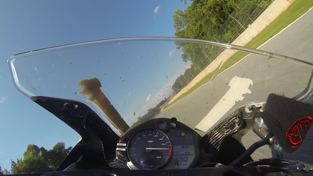

Here's a cool shot from the last South East round of the year at RA.
A little screen cap from onboard:

Tell him to check his Fuel level next time.
post #184 of 212 (permalink) Old 09-23-2014, 05:35 PM Thread Starter
That's traction control kicking in, there was some oil dry on the line.

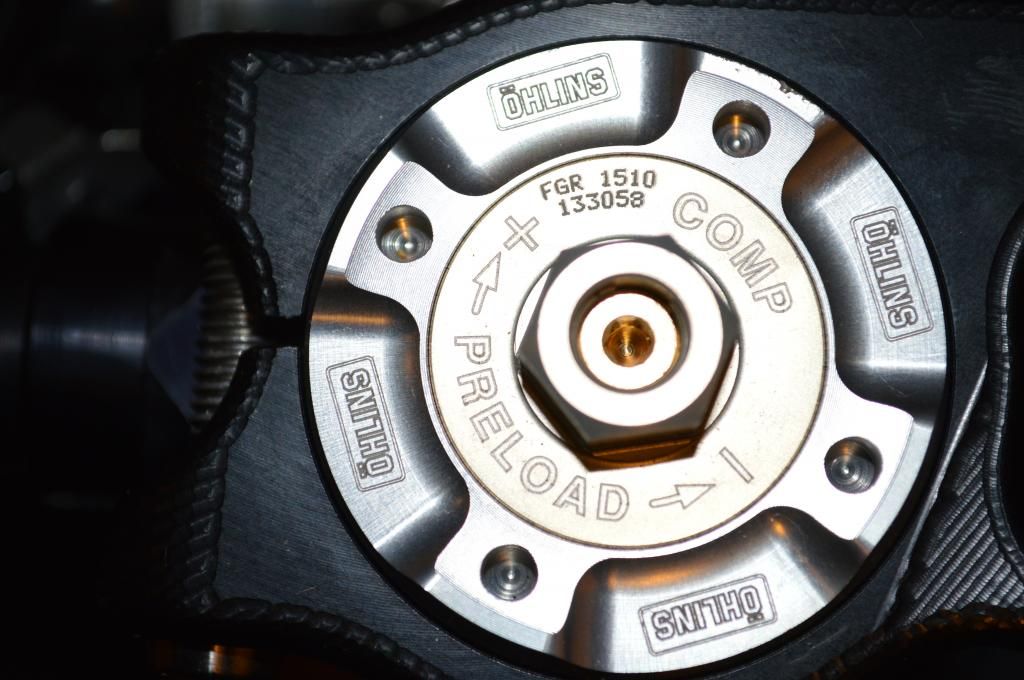

Season's almost over, but we're still trying stuff out on the bike. Latest round of updates start with an Ohlins FGR 151 pressurized gas cartridge kit.
I wish I had more photos of the install for this one, but it's been a hectic week with Daytona and the GNF so close.

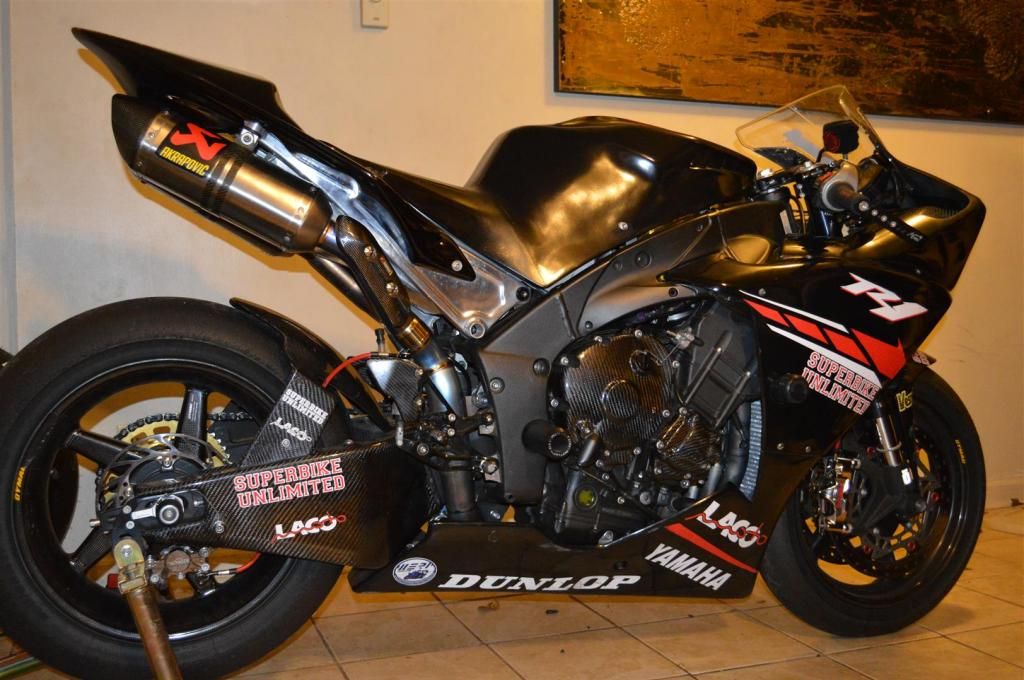

Motoholders subframe, tail removed.
Subframe, fuel tank removed.
Anthony installing the FTR subframe/underseat fuel tank.
Tail section fited.
Faux tank fitted. Assembly is mostly done, just a few more finishing touches.
