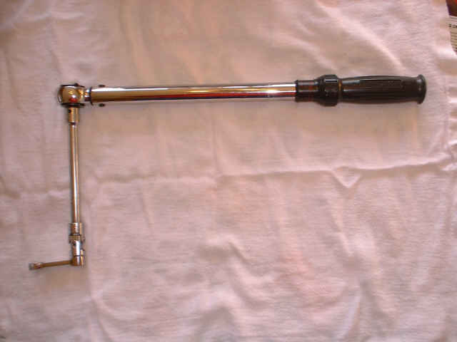

You can actually use any tool that will fit in there. It doesn't take any magic. Just grind up a wrench so it will fit, and weld a socket onto it. Then, to torque it, put a swivel in the welded on socket, put a 6" extension (or longer) in that, and then the torque wrench. Dial the torque directly into the torque wrench. You don't have to do any fancy calculations for the length of the tool. If my description is confusing, I can take a pic of something similar to what I'm describing.
The reason this works is because of the swivel. By using it, you are forced to hold the head of the torque wrench, and only transmit twisting force to the tool you made.

I went to Lowe's and picked up a 15mm box end wrench and a 9mm socket and brought both to my local muffler shop. Since it is nearly impossible to find a box end wrench without the box being offset, I had the shop grind an angle into the socket so the box end and socket were on the same plane. I also ground the box end thinner by about 4mm or so. Wrench was $10, socket was $3 and welding was $20. This looks nothing like the new style C-shaped tool, but the older style as seen in the Haynes manual. Works the same though as long as you keep the torque wrench 90* to the tool.

<TABLE WIDTH="90%" CELLSPACING=0 CELLPADDING=0 ALIGN=CENTER><TR><TD>Quote, originally posted by ducray &raquo;</TD></TR><TR><TD CLASS="quote">hi nick, i think with your tool there is a torque multipication because of the offset,that is y the factory tool has the torque wrench directly above the bolt i think you have to do a little math to get the torque reading right, please correct me if i am wrong, any body else agree or disagree???????</TD></TR></TABLE>
Ducray: Please read my post. I am not some wanker trying to get you to do something to harm your bike. This procedure works, and you don't have to do the 90 degree thing, nor any math of any sort. I can post a pic if my description is confusing. A number of people have doubted this procedure, and tried it out on a Snap-On torque wrench calibrator. It works.

I understand. I was skeptical at first, too. It's not something that's taught anywhere I can find. The only place I have ever seen it was in the BMWMOA magazine. In case anyone's interested:

"i think with your tool there is a torque multipication because of the offset,that is y the factory tool has the torque wrench directly above the bolt i think you have to do a little math to get the torque reading right"
There would be some math required if I used the tool as an extension of the torque wrench, but as long as I keep a 90* angle between the tool and torque wrench, there shouldn't be any problem.
