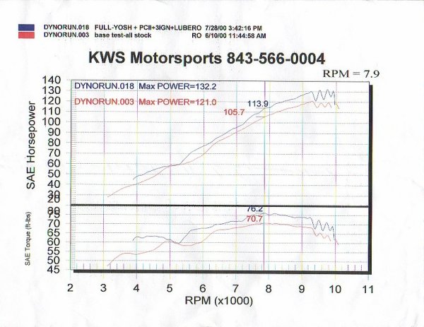

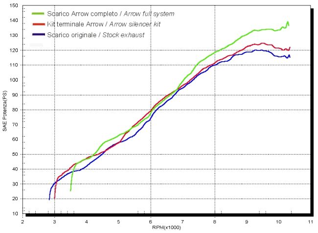

Old 11-08-2009, 02:03 PM
mrgrn's Avatar
mrgrn mrgrn is offline
Location: Live free or Die
Posts: 13,129
http://www.rc51.org/dyno/arrow.jpg
http://www.rc51.org/dyno/dmfyosh.jpg
Horde has some too, will go sort those and you can ask dstewart and others with race bikes what they are running as well for some other opinions

i disagree DS. the yosh full out performs with mapping most, if not all slip-ons above like 7000 rpms on a street bike FWIW
most aftermarket fulls measured the OEM honda headers and have the same length primes and the same off the head tapers, all of them in fact
I also have the capability to make 60mm fulls with HRC collars i bought for the heads stephen
