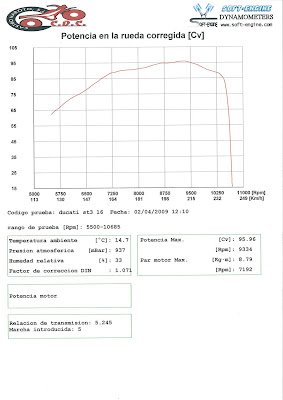

Now we are making a custon map for the rapidbike.
http://http://www.youtube.com/watch?v=J86R3qsueAo
I hope today will be ready !!

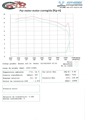

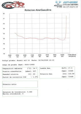

Does it idle better now than in the video?
Old 04-03-2009, 09:58 AM
Join Date: May 2007
Posts: 9
Originally Posted by Ben710 View Post
[youtube]J86R3qsueAo[/youtube]
Of course, that run was done with the st3 injectors changed to the 916 injectors, without changing the map.
Now it has got a good map, and idles
Here are the dyno charts:
