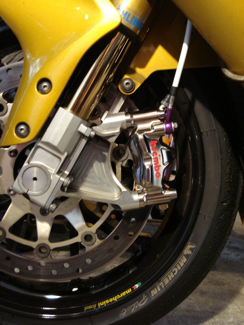

Plus Mattias is great to work with, the ends can be rotated for easier/better fitting, and they will make a 3 line (or one line depending on how you look at) kit. The 3 line kit looks cleaner, routes easier, bleeds easier, and allows a single banjo bolt at all three positions for a couple grams of weight savings and added clearance when using full lock or dealing with street fairings. Highly recommended!
